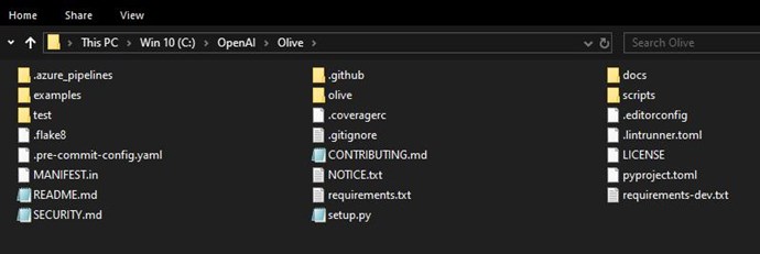

I have a directory structure, like so: C:\OpenAI\Olive
The olive directory has the version of Olive 0.2.0 Github Files, extracted inside this directory: 'Olive' so it looks like this:

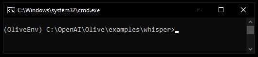

Ok, so now you're set, you can move to the working example directory in your terminal:

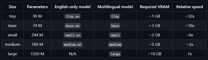

Whisper has a good range of Models:
You really want to be careful and not run these big models on very basic hardware, it will create nothing but problems if you push the boundary of your Hardware.

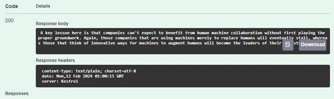

Working Model
I got a model working very easily, using Swagger and a simple WebAPI:
It works very well, its fast and accurate!
